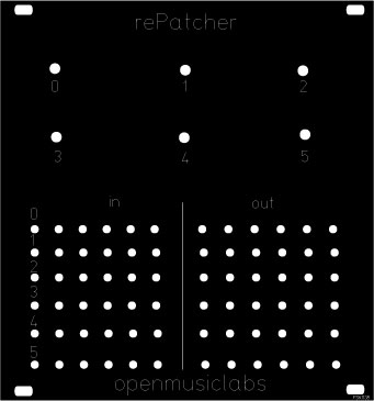

by FSK1138 » Thu Feb 09, 2012 00:07 UTC
as soon as i saw the repatcher i thought -eurorack-!!!

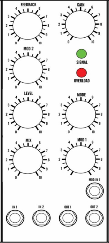

by schmidtc » Thu Feb 09, 2012 18:41 UTC
It's neurotic I know, to make patch sheets for a modular, but here's the panel drawing for the microdec in 5U. It could use some fixes of course, but it's sufficient for me.
If another file format is of use to anyone, I'm happy to pass it along.

by FSK1138 » Mon Dec 10, 2012 01:27 UTC
here is the updated euro front panel 42hp - lots of room for patching and knobs may add front usb
