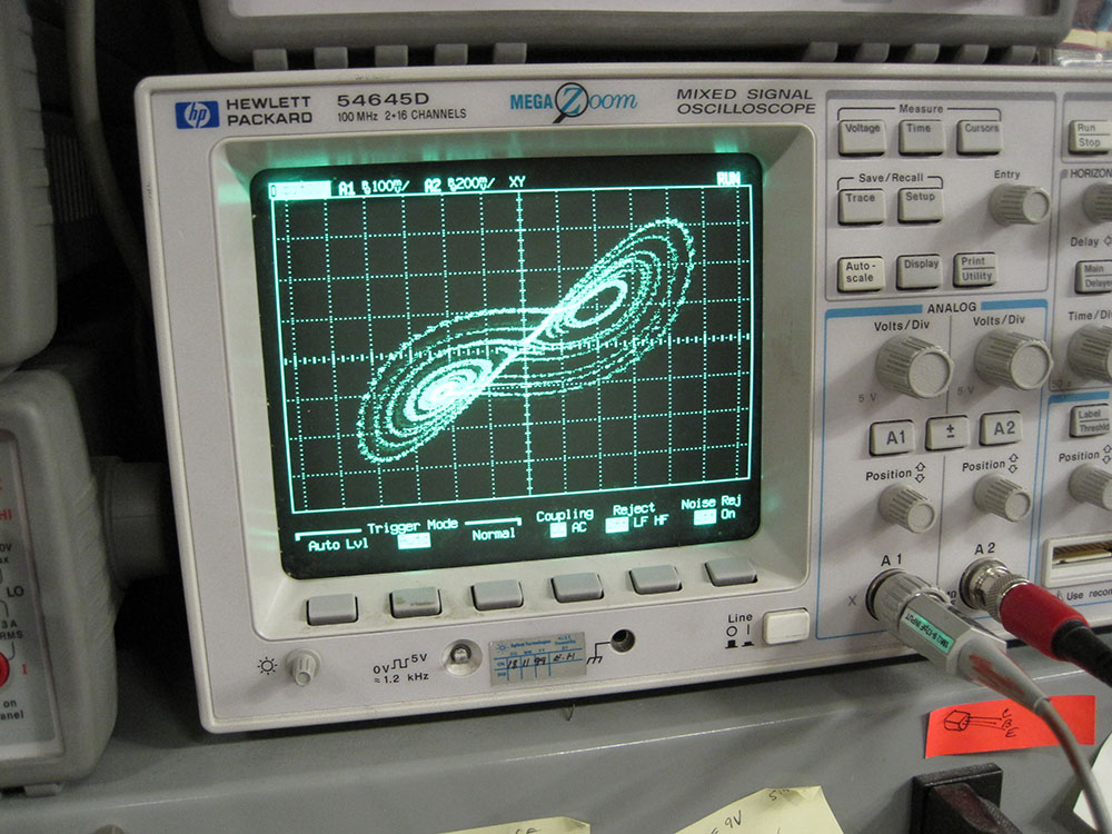

guest and I were hacking on the Audio Codec Shield tonight and we made a program that makes the Lorentz attractor!!! It has X and Y outputs. You can listen to them or watch them on a scope!!!

Or better yet, download the program yourself and change the constants! The main numbers to change are a, b and c. In the first iteration, we used the classic values 10, 28, 8/3, but there are other ones out there to try. Try looking up "lorenz attractor values" to get some other ones to try.
Here's a short video of in which the time constant, which is controlled by one of the knobs on the Audio Codec Shield, is turned up slowly, speeding up the iteration rate of the strange attractor:
