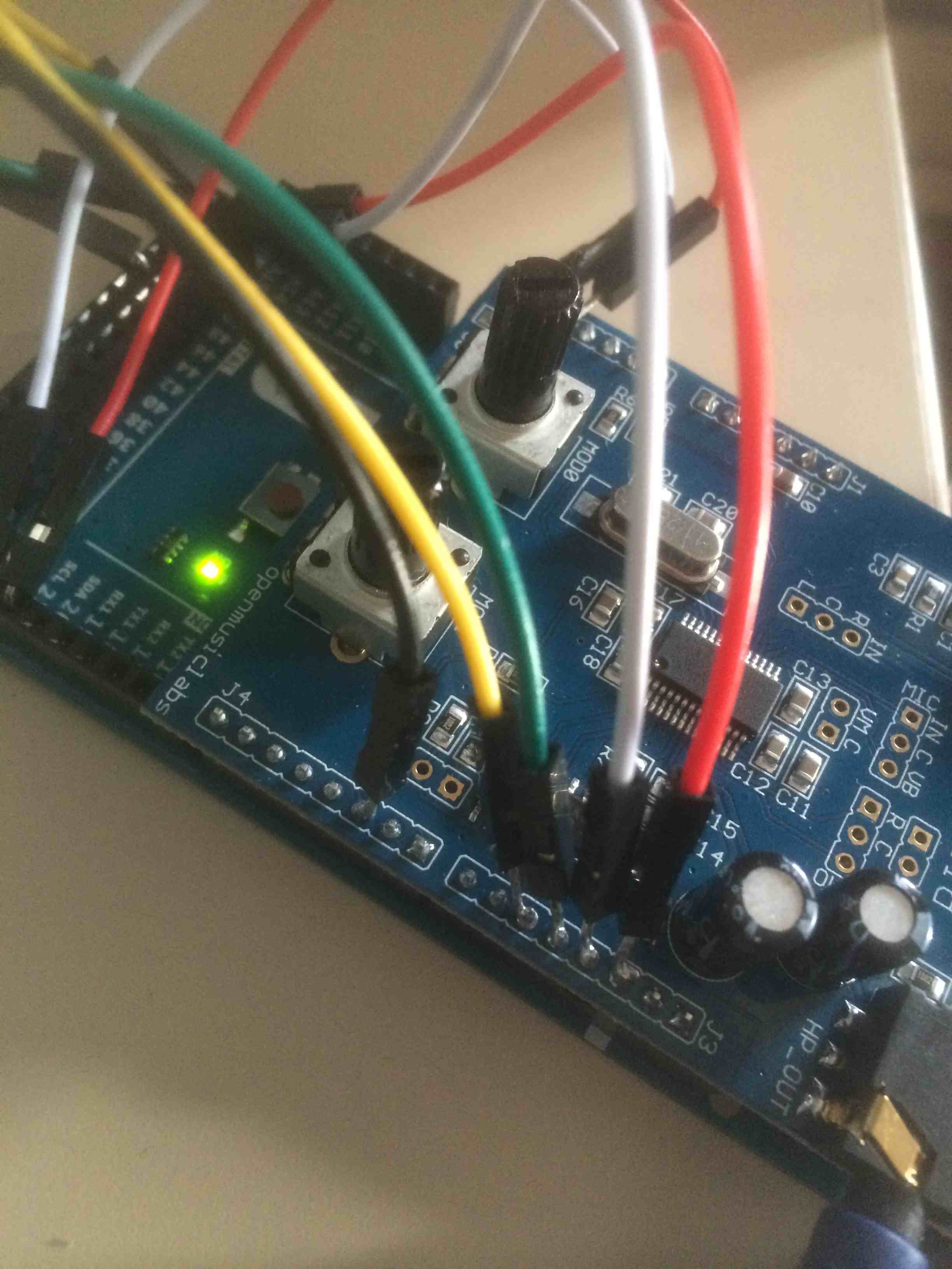

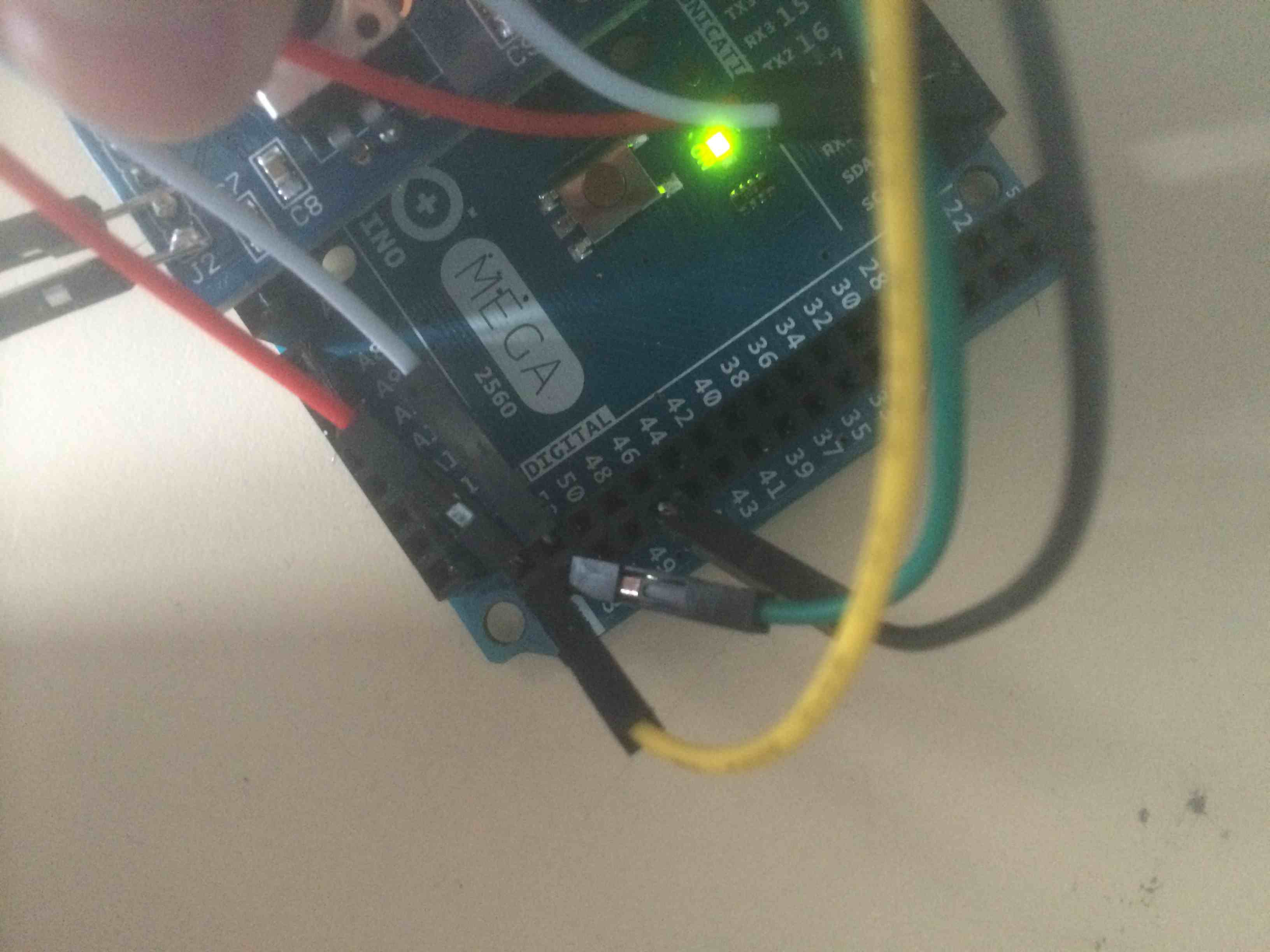

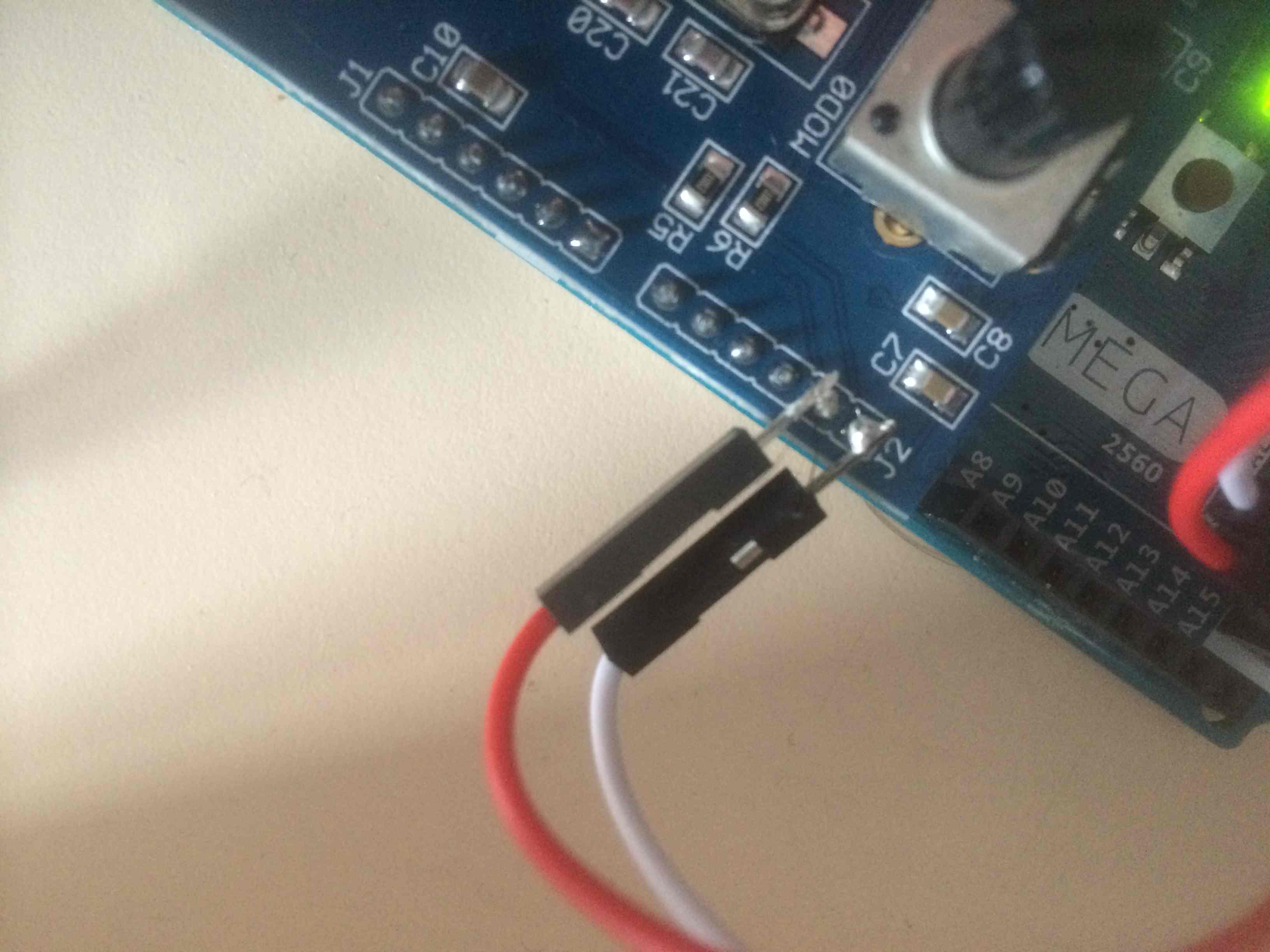

Photos of my board (the pins where each jumper cable soldered to the board have been clipped):
Images of mega2560 with audio codec shield
2
3
P.S. Thank you for the very very very prompt support you are giving!

from the second picture, it looks like your spi wires are going to the wrong holes. they all seem to be shifted down by one. the last holes are all ground on that header, so it should start with the second to last. there should only be a one hole gap between the spi lines and the clock line on 47.
if that is all correct, and it still doesnt work, then try this experiment:
1. leave the shield plugged into the mega, with the mega powered on.
2. get a regular arduino, and connect the grounds between the mega and the regular arduino
3. run the wires to the regular arduino
4. see if it works with code loaded onto the regular arduino
Re: Have the shield working with Mega - library attached
by Brownian Lotion » Tue Aug 12, 2014 09:55 UTC
Wow... oops.
You are absolutely right, the pins were in the wrong spot. Moved them one slot to the left and now it works perfectly!
Thank you! And sorry for asking a stupid question, I should know better.
