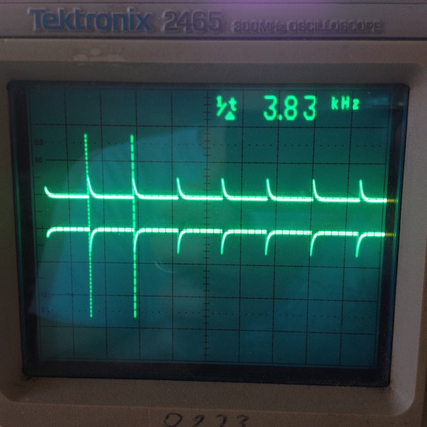

I ordered a Mixtape Alpha board from OSHPark (looks great in purple and gold!) and put it together this morning without much trouble. The mixtape.hex flashed and verified via avrdude without any problem. When I power it up, though, it screams at around 3800 Hz, just ear-splitting. I tried mixtape_avr_new.hex instead and it's even worse. The buttons react as expected, and they change the noise it's making (usually louder and more painful), but it's always got that 3800 Hz tone going.
Any thoughts?

did you set the fuses? im betting the CK/8 fuse hasnt been cleared. there are a few other fuses that need setting as well, you should take a look at the top of the .asm file for the correct fuse settings. awesome job, by the way. and definitely use the new_experimental.hex.

That was it! Thanks so much! We'll be putting the other 2 boards together tomorrow at our local hackerspace open night, really glad to have this sorted before then. My hope is we can get some visual artists interested in doing custom art for a second batch.

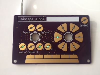

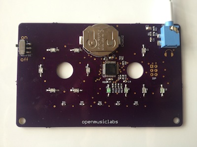

Here's how they came out:

the mixtape looks great. be sure to clean the board really well, as the flux can make it work poorly. also, if you end up doing another run, you may want to tent your vias, as it gives the surface a cleaner look. did you make those straight from the gerber files? or did you rerun the gerbers from the eagle files?

I made a couple of tweaks in Eagle—used a different battery clip I had laying around, and changed the ISP header for pogo pins.
Good point about the vias, thanks!
