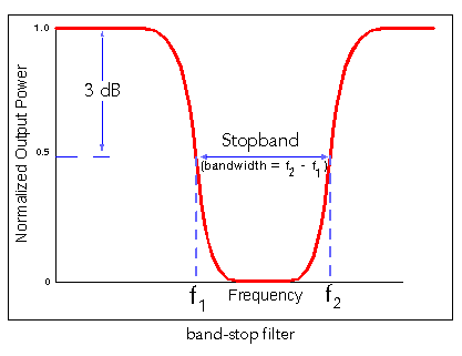

I need to create an electronic device that will filter a range of 1 full octave,
half an octave below a desired frequency and half above it.
I want to be inputting a full frequency range of sound and outputting the same sound with the removal of that octave.
This is a one time setting and it will not change often (but it will every now and then) so I don't need any setting components on the device itself.
I want to be able to pick any frequency (20Hz to 20KHz) by putting it in the code I'll have and then uploading it to the Arduino (I Have an Uno) the removed range should be properly filtered, I wish to get the best result in terms of db reduction and with minimal slopes before and after the removed region.

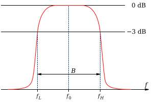

would I better use a "dual" band-pass configuration?
or a low pass filter and high pass filter?
I am not a sound professional but I know a thing or two and I've read some..
I also read that an analog notched filter could remove a frequency better compared to an analog band stop filter in terms of db (generally speaking), but it I understood correctly, notched means it's for a specific frequency and not for a range of frequencies?

the decision over notch filter versus HP/LP combination is usually based on the bandwidth you want. the more narrow the bandwidth, the better a notch filter will be. the wider the bandwidth, the better a HP/LP combo will be. a single octave could be done by a notch filter, but the depth wont be so good. you could do a series of notch filters at staggered frequencies to get better cutoff characteristics. or you could go to HP/LP, but i think that might be more processing time.
